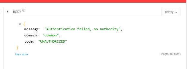

The auth token that we've received is expiring immediately even though the expiration of the token is 24 hours.
We just followed the documentation/procedure on Server Token (ID Registration Style).
Thank you.
Here is the attached screenshot of the response
    Have you issued a token with the same authentication key after issuing a token?
    Even if the access_token is still valid, if the token is reissued, the previous token becomes invalid.

    Thank you. I have solved it. Does it happen in service token too?
    2019.11.26
    Authorization Code for issuing Service API Access Token is valid only once.
    Token cannot be reissued with the same Authorization Code.
